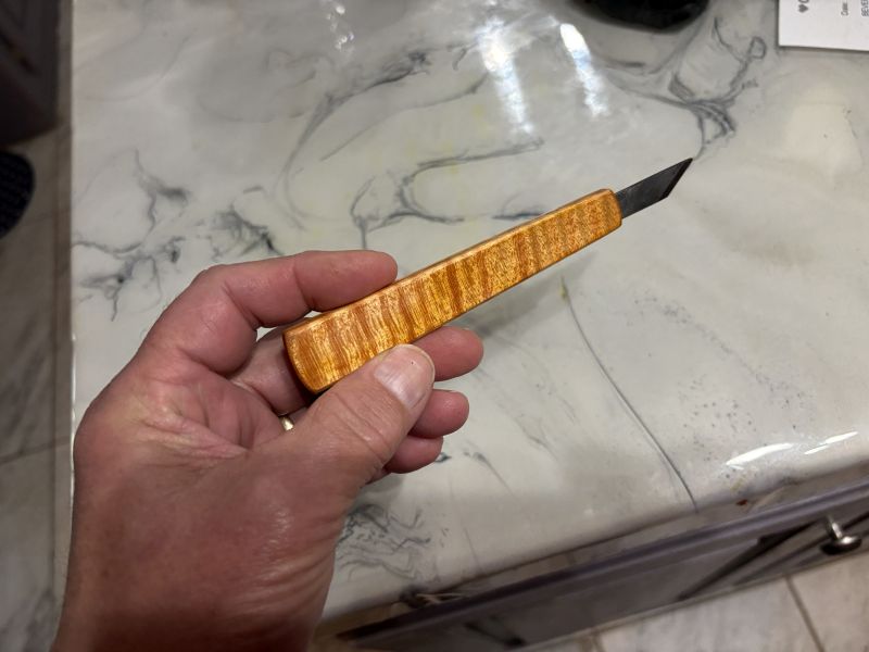

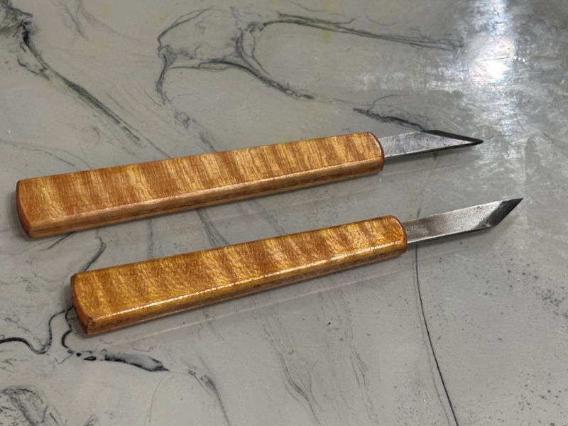

It has been about a month since I made progress on the violin, too many other things going on. But I did take time to make handles for a couple of my knives and used these as a test for ground varnish. Here's a link to a short video and a couple of pictures.

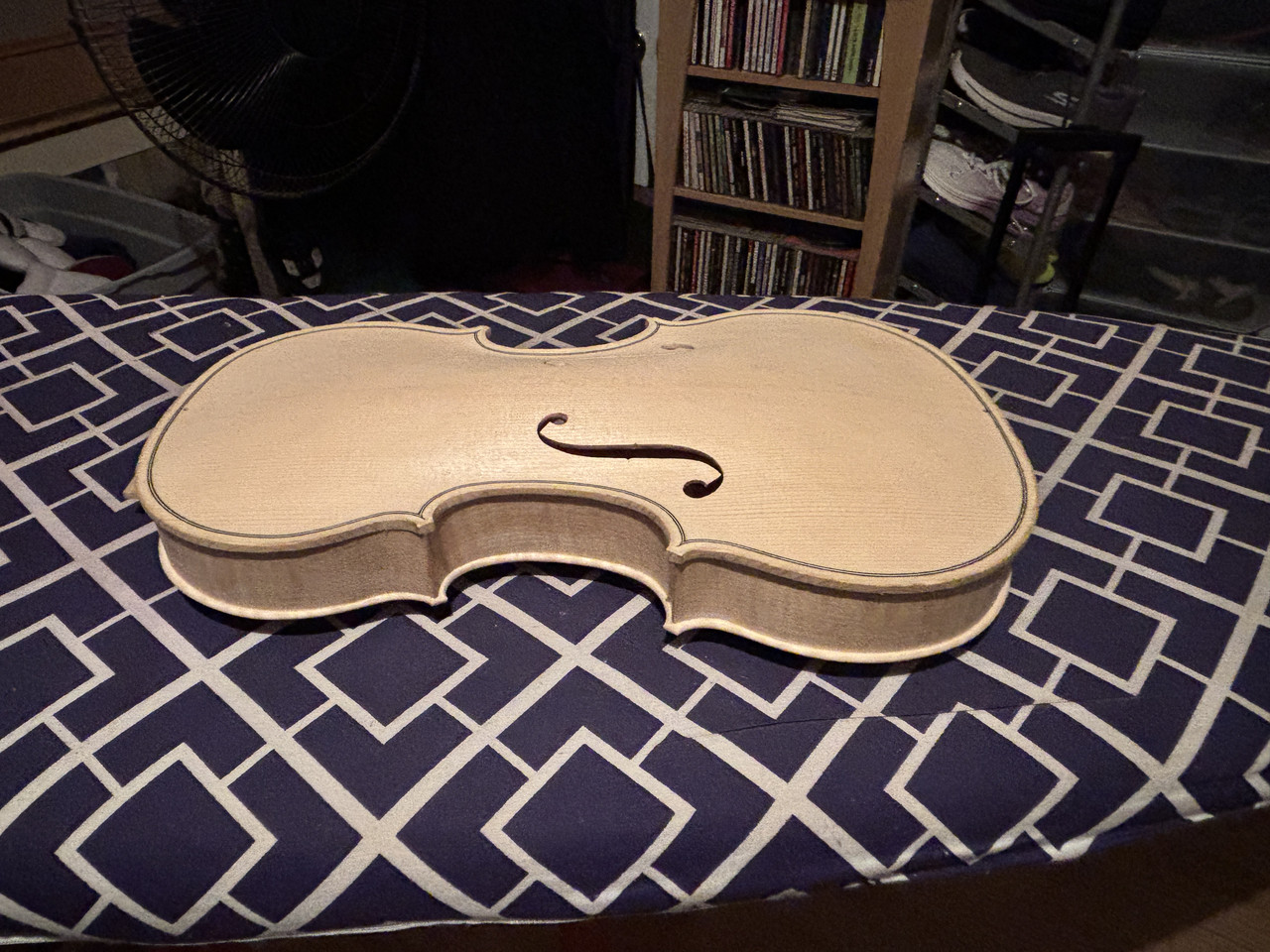

I finally decided to make some progress and glued the top plate to the ribs after being lazy and putting it off for a while.

Do you remember the excitement of releasing the body from the clamps? That`s always a special moment. This stage is the halfway point . Getting the neck on is the second big one. Artists (painters) talk about the time when they "abandon" a painting . Whatever second thoughts they have it stands on it`s own feet from now on . I feel this violin will be very special . The film of it being made is part of that .

Hi John, yes it's nice to get the clamps off and have the box finished. I spent some time the last couple days rounding over the edges. I didn't video that since I did video the rounding of the back plate edges. So yes the next step is the neck so hopefully I can get started on that soon.
I have a neck template that I made from a sheet of brass but I think it needs some improvement. I'm going to work on a new neck template first before I start cutting wood.

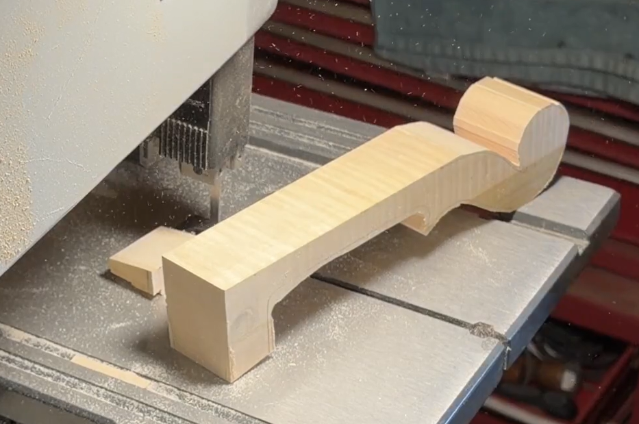

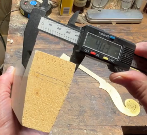

I got some work done on the neck block this weekend.

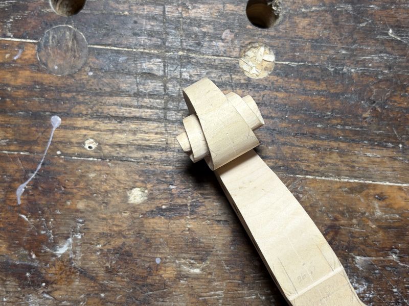

PostPosted: Wed Jun 03, 2026 7:21 pm    Post subject: Reply with quote
Making progress on the scroll.

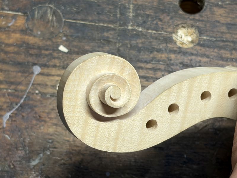

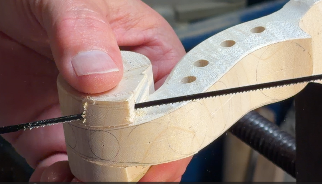

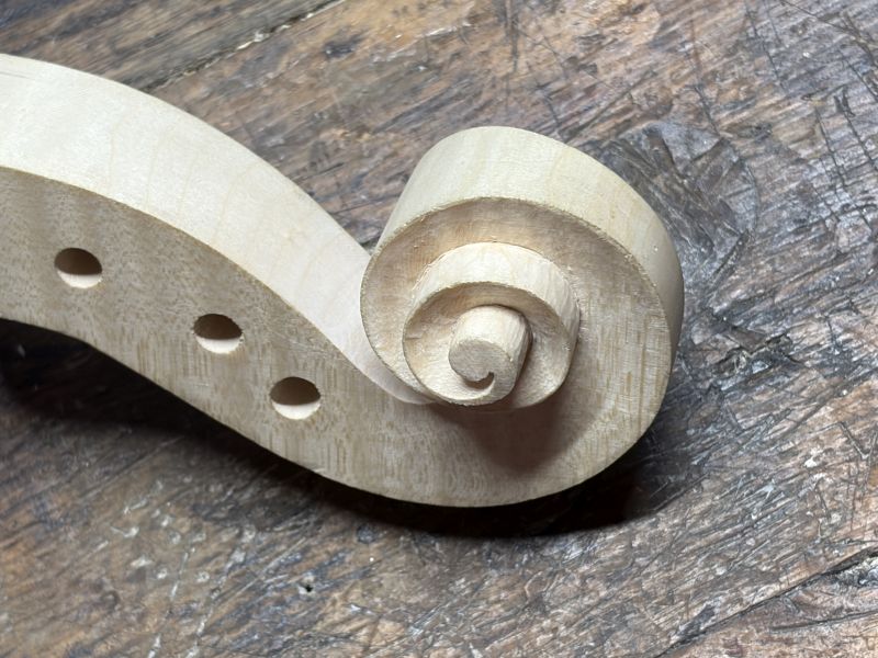

PostPosted: Sat Jun 13, 2026 10:24 am    Post subject: Reply with quote
Doing some refinements on the scroll sides. Basically finished, still needs the chamfer. Maybe a slight little bit more refinement.

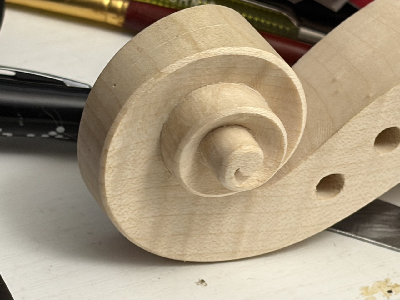

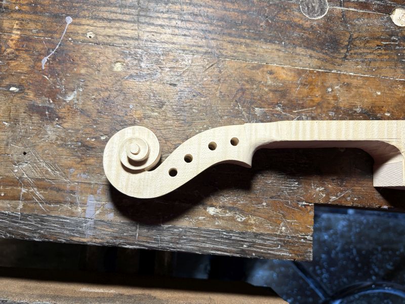

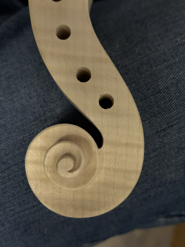

PostPosted: Fri Jun 19, 2026 2:24 pm    Post subject: Reply with quote

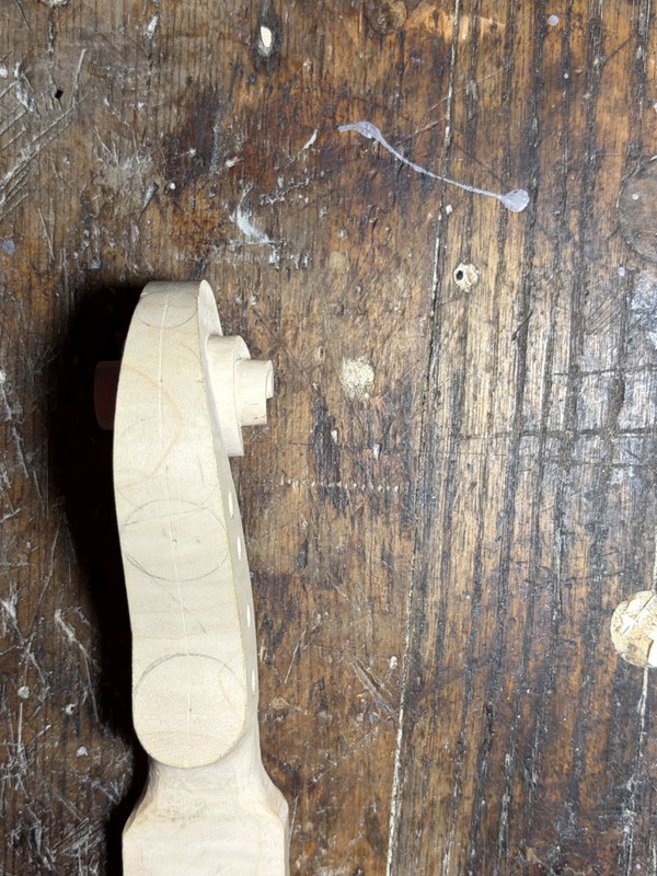

A bit more refined now. I have made the chamfer around the turns. I think I'll open the pegbox next and then do the fluting on the outside surface.
The second image is upside down but shows the throat open, not too tight in there.
I like leaving a little flat area coming out of the eye so it looks like a 'comma'
