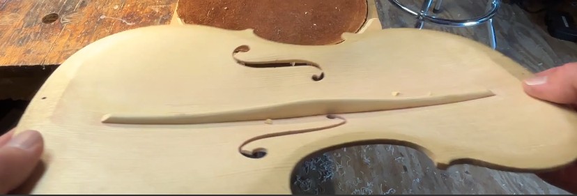

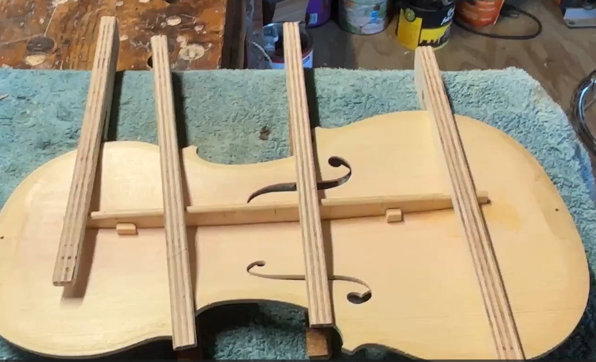

I finished the bass bar. Here it is clamped for gluing, and finished.

What I notice is the highest section of the bassbar is away from the bridge position . Is that for a special purpose ? There are several opinions about bassbars and you may have reason for that .

The questions and answers about plate thicknesses will also apply to bassbar shapes and positions .

Middle of the bar is pretty much standard in the restoration community (where people don't feel the need to leave their personal mark or eccentricity). The weakest spot on the top is the narrow isthmus between the tops of the f-holes and the most pressure is at the bridge, so this strategy more or less splits the difference, considering them equally.

Very Happy I do a lot of research and reading and found this on Maestronet, so rather than typing it all out, I'll copy and paste from that post.
I used these measurements mostly although my height measurements may have been off a little bit because of all the different things I've read.
Also I read somewhere that the highest point of the bar is about halfway between the bridge position and the center of the plate.
Roger Hargrave also has a PDF document about shaping the bass bar which influenced me somewhat.
I try to learn from the best makers as much as I can. They share a lot of good information!
Here's the quote, I think it was someone quoting something that Michael wrote in another thread, maybe on this forum somewhere.
"I use a simple plan that is based on something I got from the Carl Becker shop, who get full credit for it. The basic idea is to measure the bar height including the top thickness, with a graduating caliper. Divide the bar into eighths (nine pencil marks, including the ends) and the thickness of top plus bar is 5.0mm, 7.6, 10.2, 12.8, 14, 12.8, 10.2, 7.6, 5.0, from one end to the other at each mark.
It's simple, gives exactly the right profile, and compensates for top thickness. I start the bar 40mm from both ends, and it's 5.5mm wide, 1mm inside the outside foot of the bridge, and 12mm from the center of the upper bout and 15mm from the center of the lower bout.

Yes, those numbers are from me, from Beckers.

Davide Sora has a video about bassbars. He finishes with a stylish final shape . G plan furniture makers must have been an influence there .

Davide's bar has a rather long flattish section.

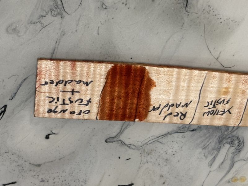

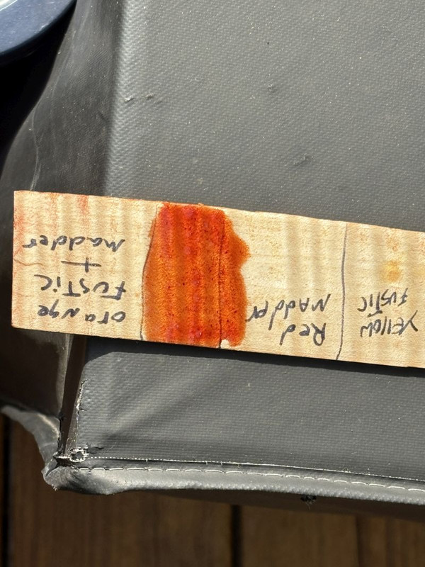

Another lake pigment experiment.
These two pics are the same sample, in sunlight and in the kitchen under florescent lights. The red looks more red than in person and the brown looks more brown than in person. The real color is somewhere in between but it's hard to get it to show accurately in a photo. Ignore the writing, there are other lake samples on the other side.
This is a mix of red madder, yellow fustic, cochineal, and Iron sulfate. The iron sulfate is from a discussion with Davide Sora, 10grams iron sulfate in my usual espresso madder but then I had to add alum to make it precipitate.

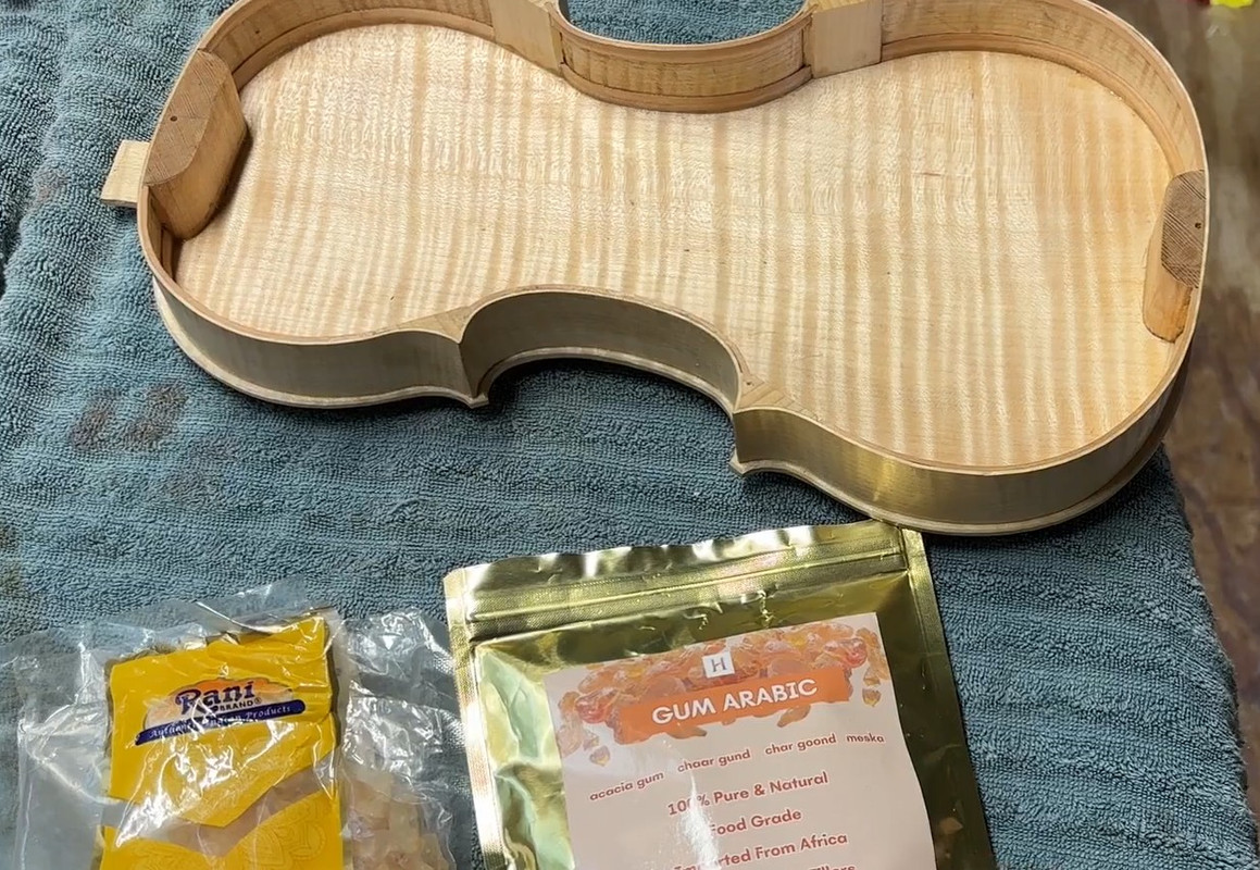

Applying a size of gum tragacanth and gum arabic to the inside. I may thin it down and use it on the outside also, especially on the end grain areas.
