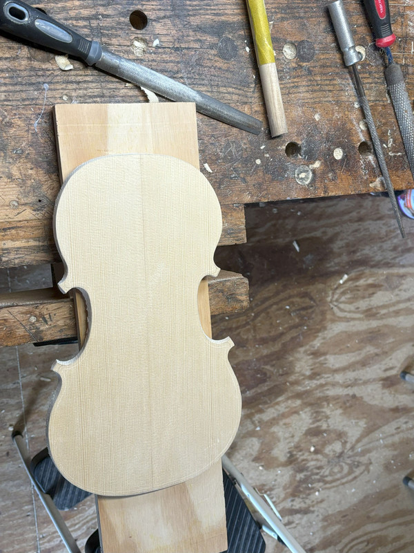

I've been working on the outline of the top plate. Leaving the corners long. I'm not quite satisfied with the shape of the corners on the back plate so I'll try to do better on the top plate.
Also I ran a washer around the ribs when marking it out and that gives me about a 4mm overhang which is too much so I'll have to reduce that. But this is good for a preliminary outline.
Next I'll mark edge thickness and thin it down some and start the arching.

PostPosted: Wed Jan 22, 2025 8:32 am    Post subject: Reply with quote
Thinning the edges. I start out at 5mm all the way around. Later I'll thin the bouts to about 4mm leaving the corners at 5.
